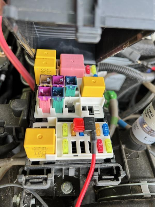

1. The provided fuse does not fit snug in the fuse box in any position. The blades stop inserting when the black plastic portion is reached. I did attempt 2 different grounding solutions.
2. The directions show a different fuse box than my 2022 has.

5. I reconnected the original harness and the running and brake lights illuminated again.
