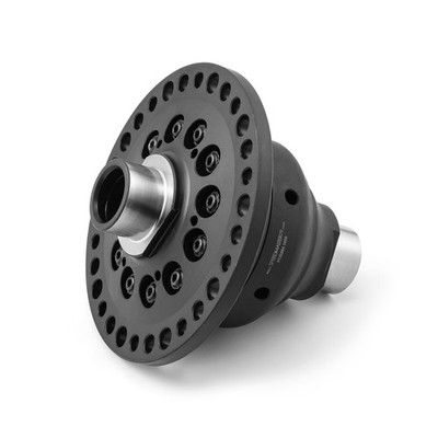

Auburn Gear High Performance Series 19 Spline Differential Dana 44 5420112
