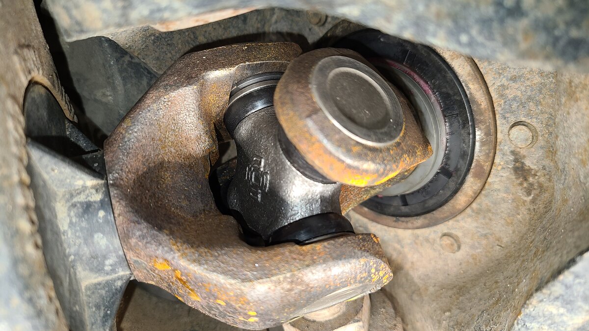

Recently replaced all front wheel bearings and seals along with the upgraded spindle seal. Both front axle U-joints were bad as well. Sourced everything from the local parts stores.
Spindle seal is metric and part numbers equate to the seal size. 42mm x 72mm x 8mm. V wiper seal butts up against it to keep more dirt out
Since pictures can get blurry when zoomed I'll make a list of part numbers off the boxes
V seal wiper- Napa SKF #400400
Spindle seal- 42x72x8TC-BX (From Motion Industries in Grand Forks ND)
Front wheel hub seal- National # 472015
Wheel bearings and cups- Napa #'s LM501310 VP
LM501349 VP
BR24720
BR24780
U-joint- Precision # 365 or 83286

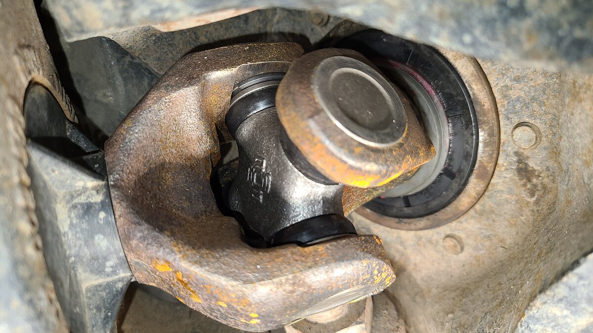

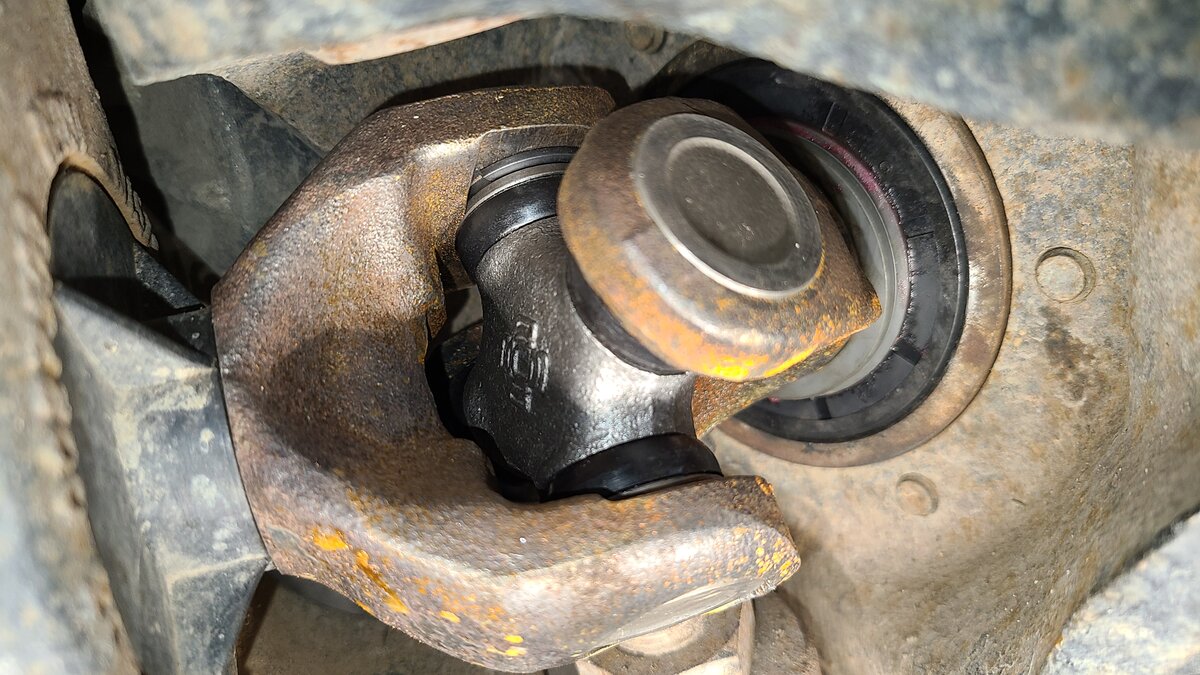

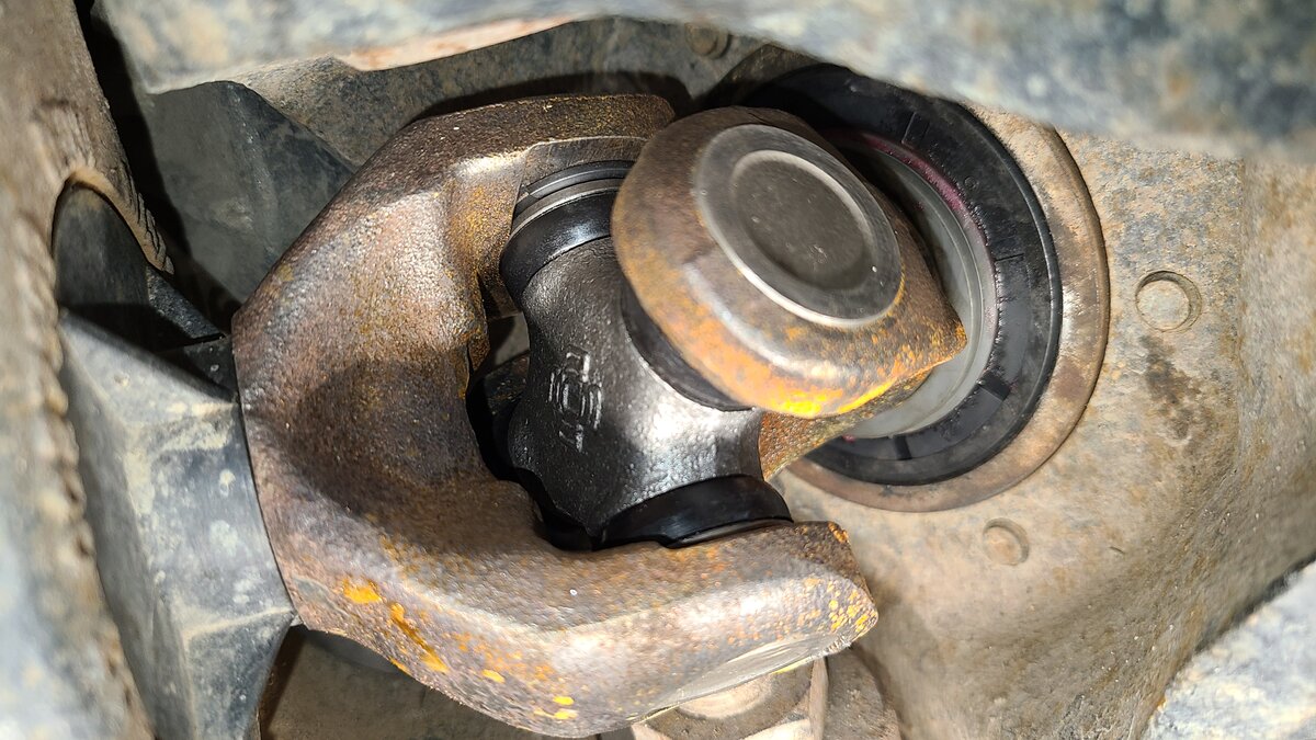

As far as the V wiper, I looked at the seal kit that Torque King sells and the guys at my local parts store found me the same seals. The v wiper is on the axle shaft right outside of the U-joint and butts up against the seal. Didn't have to recess it deeper, just flush with the edge like the old one was. The v wiper is a tight squeeze get stretched over the axle shaft but seems to provide a really nice fit against the seal that way.
Hopefully my picture shows up for everyone, but it shows the grey v wiper against the spindle seal in that picture
