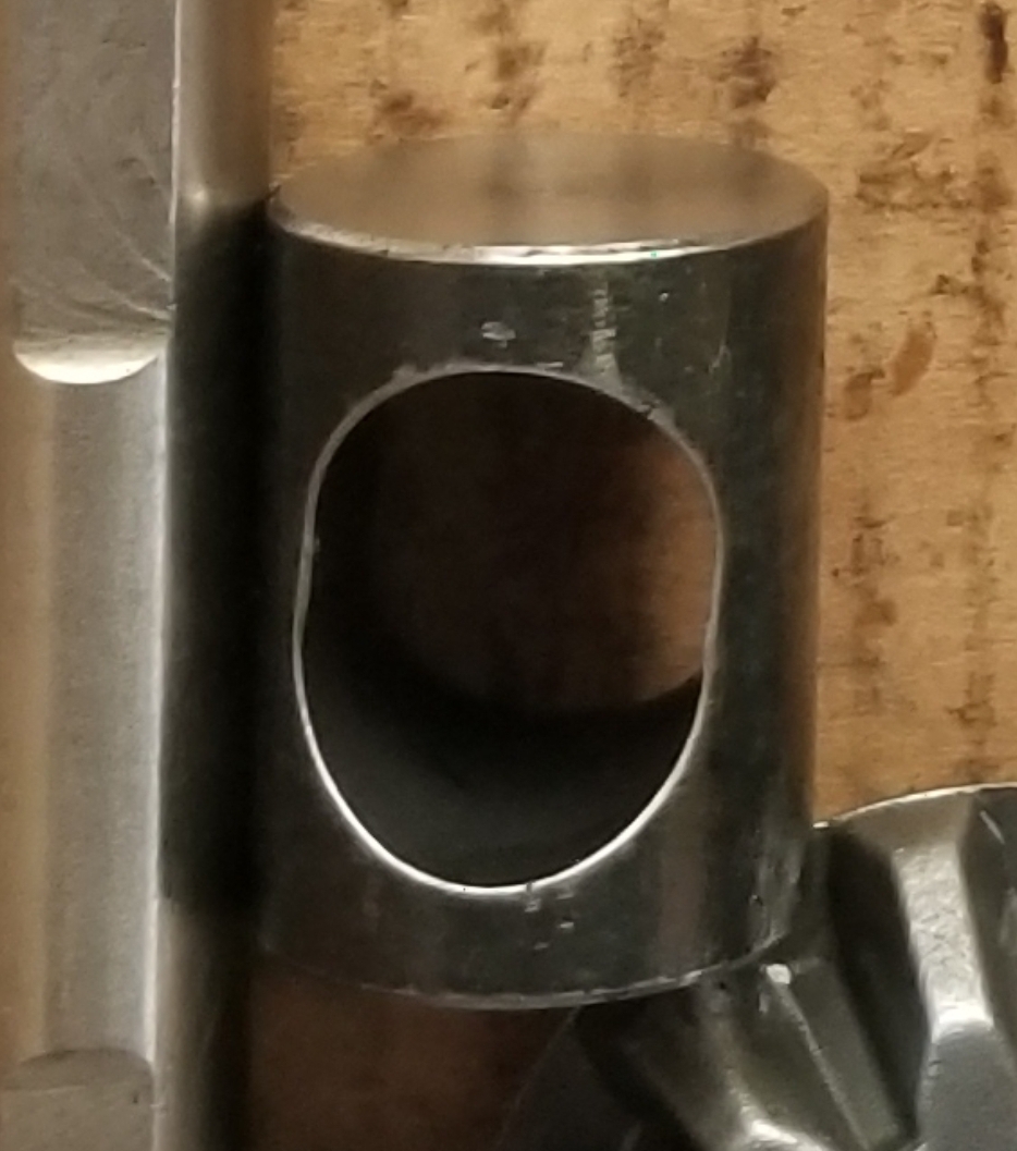

Did you put the spacer back in?
I'll find the post that just came up referring to this. It has be in the rear diff.
This is the only tread I have posted, but thanks, Where is this spacer at, I thought I pulled all the parts out of the stock carrier to install the spartan. Did not see that part.
Click the link in the post above.

Sorry, I did click on that post and ask the same question I ask here. there was not a answer to that I seem. But going bask to this spacer where is it in the carrier? I jus did not see anything like that.
I also posted it in the other thread
I will look at the carrier housing in the morning, I kept everything. I wonder why there is no mention of this in the install manual?
