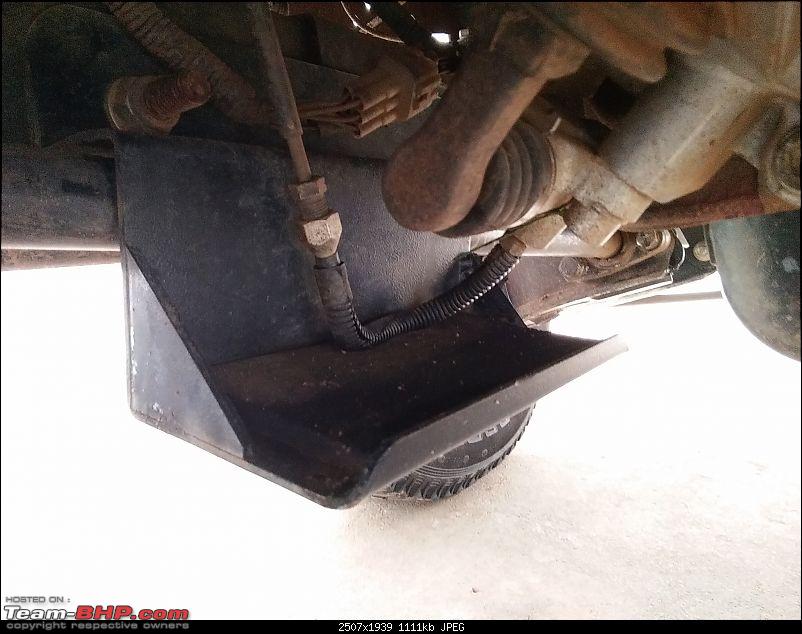

the fluid hose to the slave cylinder is hanging out there at 7 to 8 o clock position on the bell housing asking for a stick to kick up and get into the hose or the slave cylinder itself.
The clutch pipe guard for Thar.
Mahindra Thar : Test Drive & Review - Team-BHP
