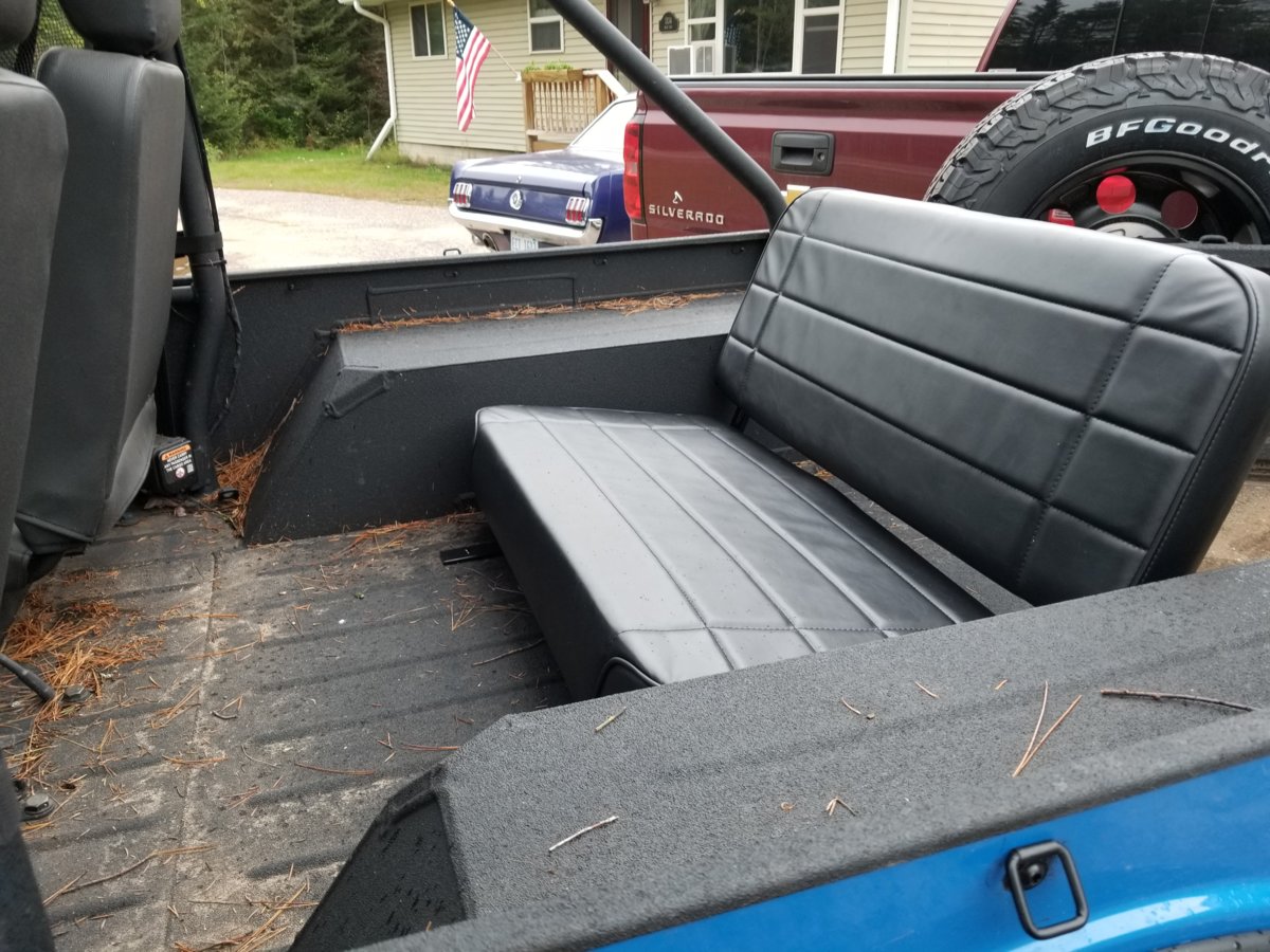

Smitty built rear seat installed.
Upman
Jul 30, 2019
9
Gwinn, MI, USA
Do not own

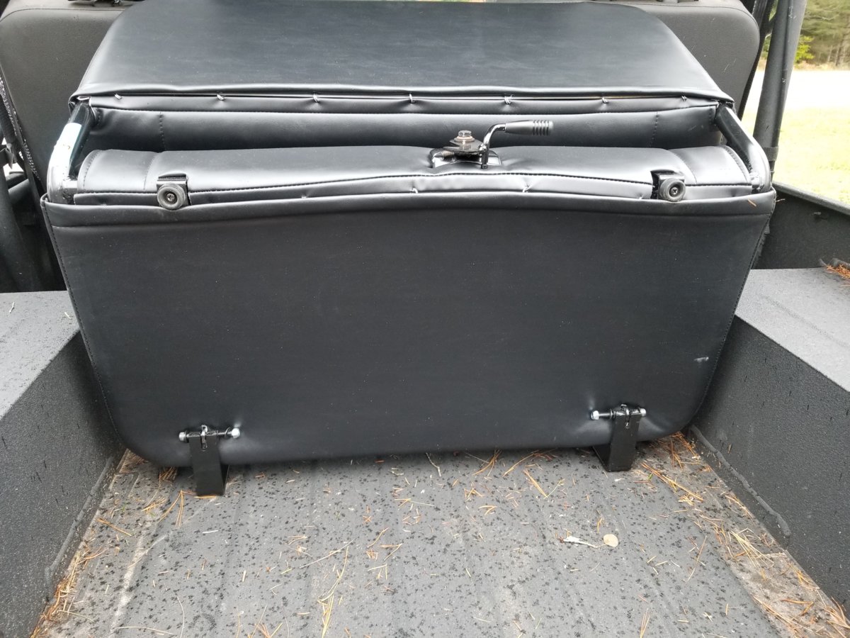

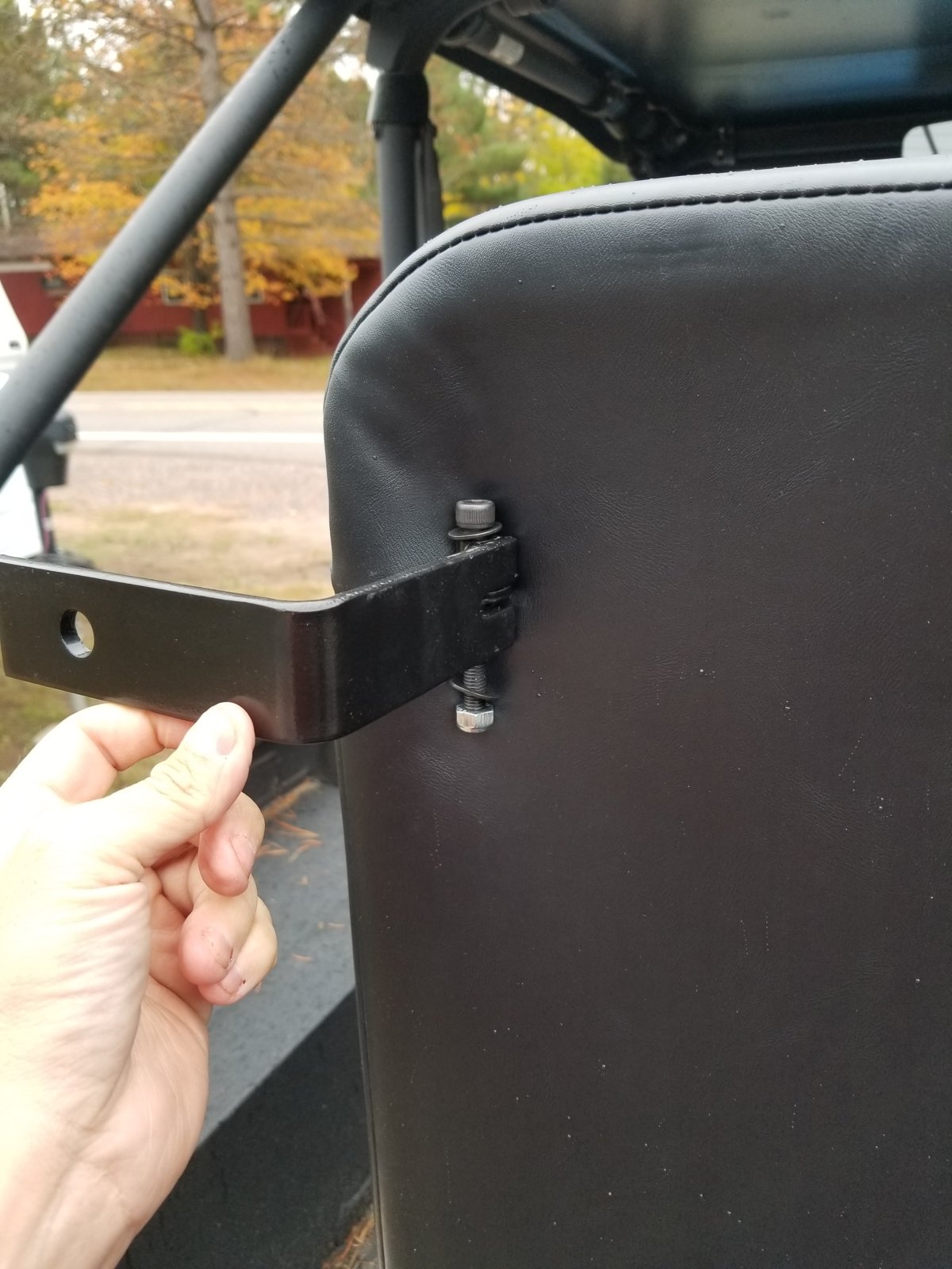

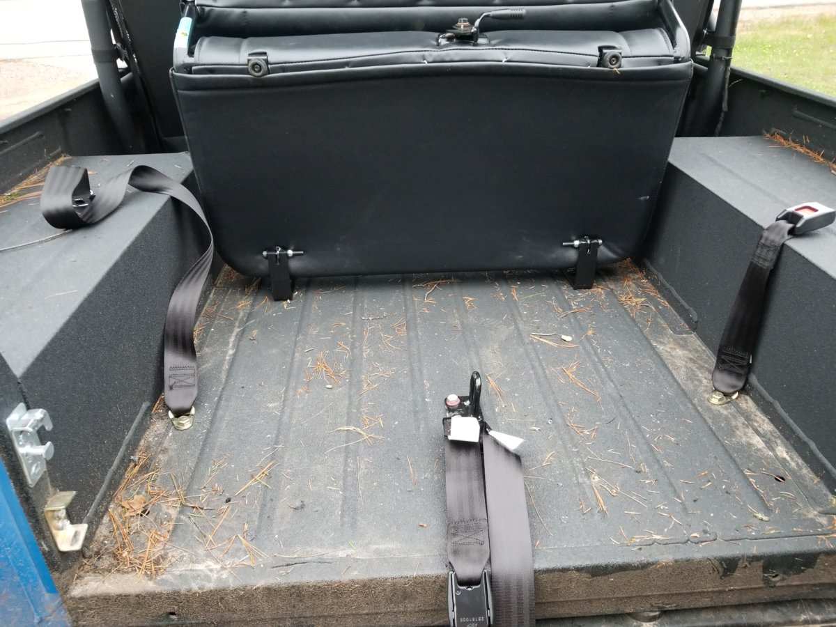

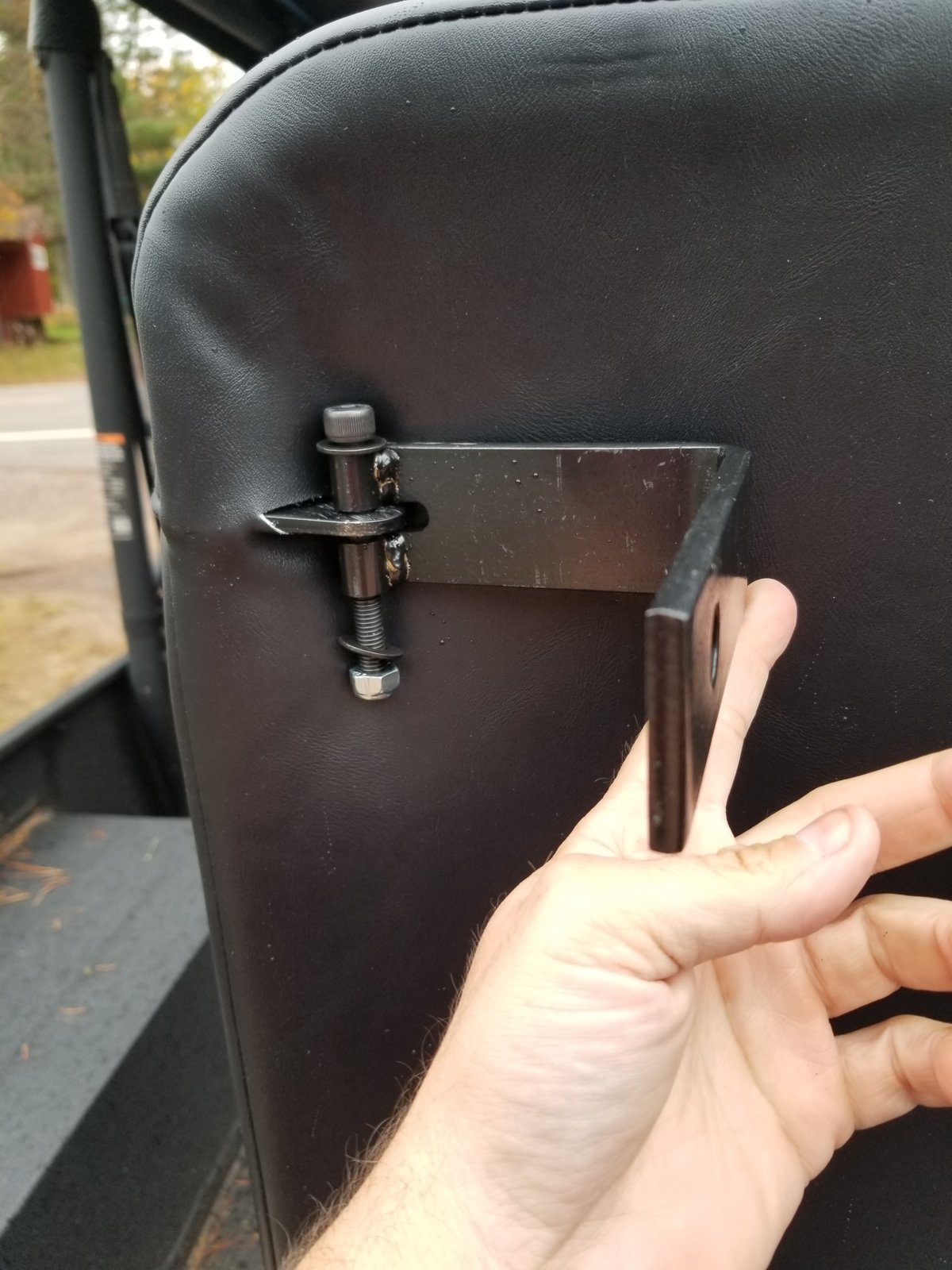

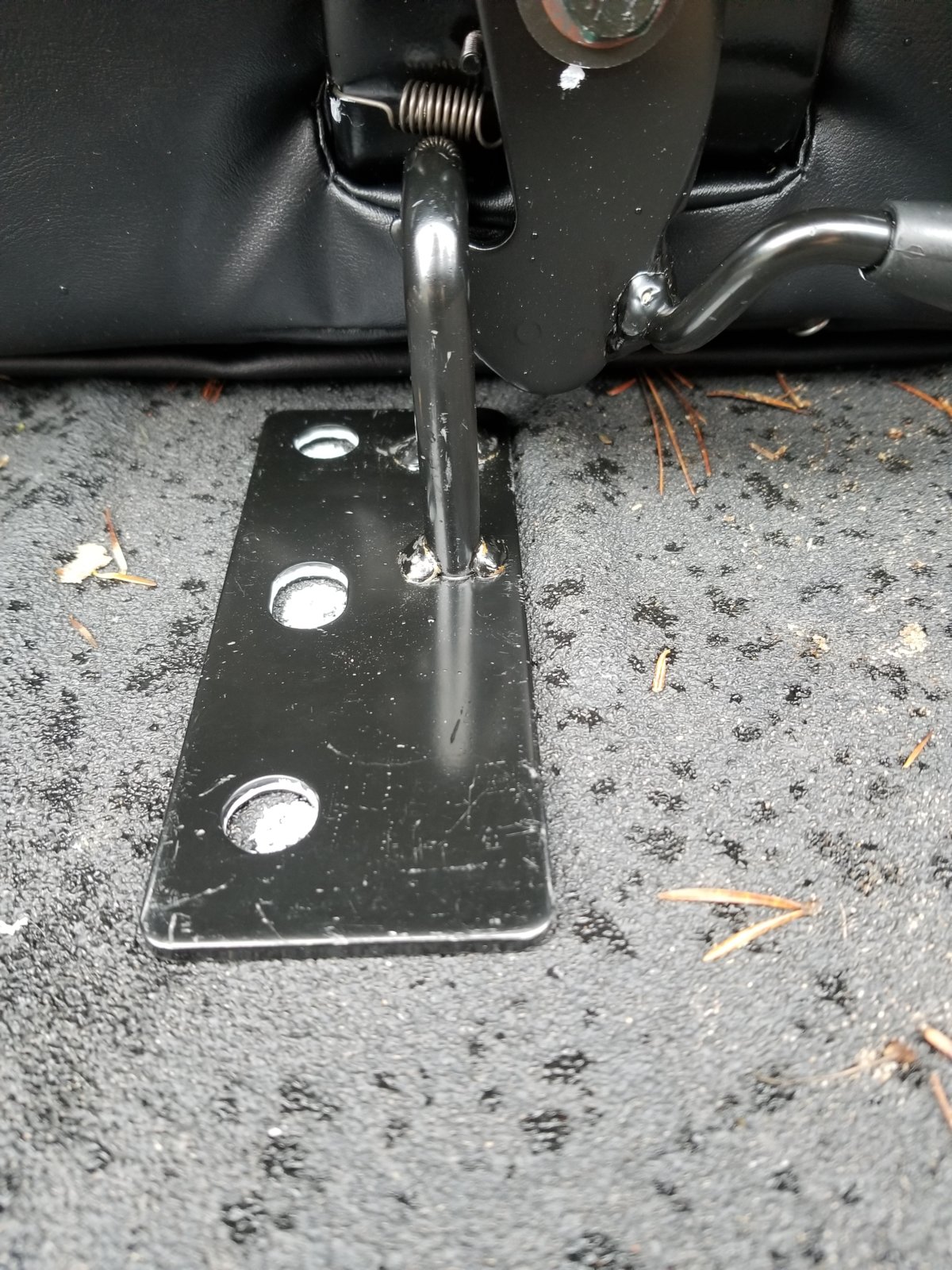

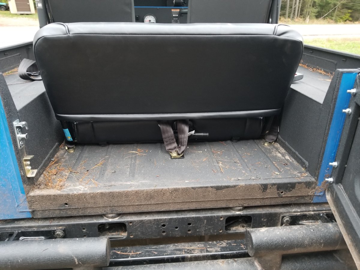

Added a Smitty built tumble style seat today along with CJ rear seat belts. Got the seat from Quadratec $172 and the belt set off eBay with hardware for $42. Both prices are shipped. Took about an hour to install. Also put one male belt on the outside and a female on the outside on other side. This way I can hook those together and hold a cooler etc when the seat is forward. Might add pins and clips to the hinges later so I can pull two pins and remove the seat. Had the bend the loop on the catch some since the bracket landed on a floor rib. So I flipped it around and then bent the loop over some to land in the catch.
