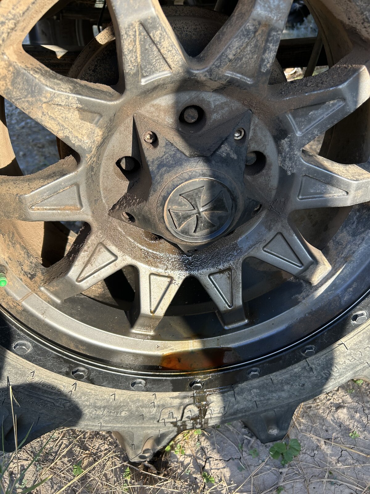

Hi guys - I am new to the forum, and just purchased a 2018 Roxor that had an Spartan Locker installed right before I bought it. Long story short, I believe it was installed incorrectly by not installing the spacer. Small amounts of Differential fluid is leaking, and can be seen on the outside of the rear passenger wheel. The Roxor is located pretty far away and is a pain to bring it back for someone to fix, especially right before deer season. My question, If I keep filling the differential fluid up each time I use it, will it hurt anything? I have attached a picture of the leak (It had been sitting for 4 weeks). I appreciate any feedback. Thanks
Mine had that problem as did many other, mine was indeed a spacer. I had a lot of Strachan noises. I would fix it asap, so it doesn't cause any more problems.
I’d get it fixed and deal with the down time. Your seals leaking cause the bearings have gone bad and took them out due to no preload on the bearings Via the spacer pushing the axle out on it. you don’t want the damage to get worse where the axle tube won’t hold a new race or damage The sealing surface on the axle/hub. Not sure it could get that bad but why chance it.
I really appreciate the feedback. I will go ahead and start the process. Thanks again
