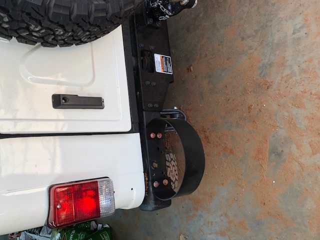

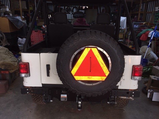

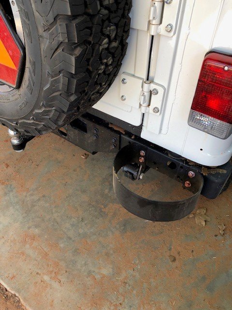

The lack of backing plate was the main reason I sucked up the price of the OEM hitch. The tube frame the hitch hooks to is not very thick. I think you need as much backing as possible. The factory hitch is 3/8" plate. Roxor 14.jpgRoxor5.jpgRoxor 15.jpg
Yep, I agree. Makes sense, the more area bolted up to the rear frame/cross member the better. Thanks for the pictures, yours looks great.

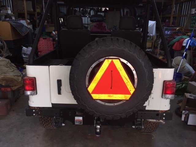

Crown automotive cj bumperet. $68 pair. Some drilling on the bumperet is required to fit existing holes. 2 fit 1 enlarged 1 new hole.

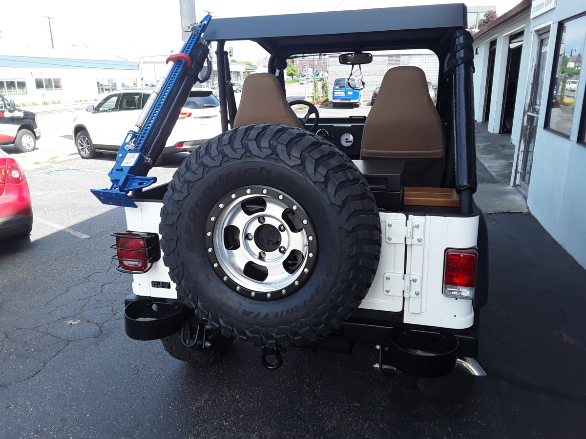

Im using those same bumperettes then painted the bolts. Added stringmade spare carried flipped sideways. The heavier tire rests on the strongmade hitch. Had to get Allen head bolts tight fit. Heavier spare so centered on the hitch to support. Drilled new holes n painted every bolt for fun
Strong made hitch was 120.00 on their site.
Heavier duty on that wimpy OEM bumper. I'm only towing a jetski & spare tire.
