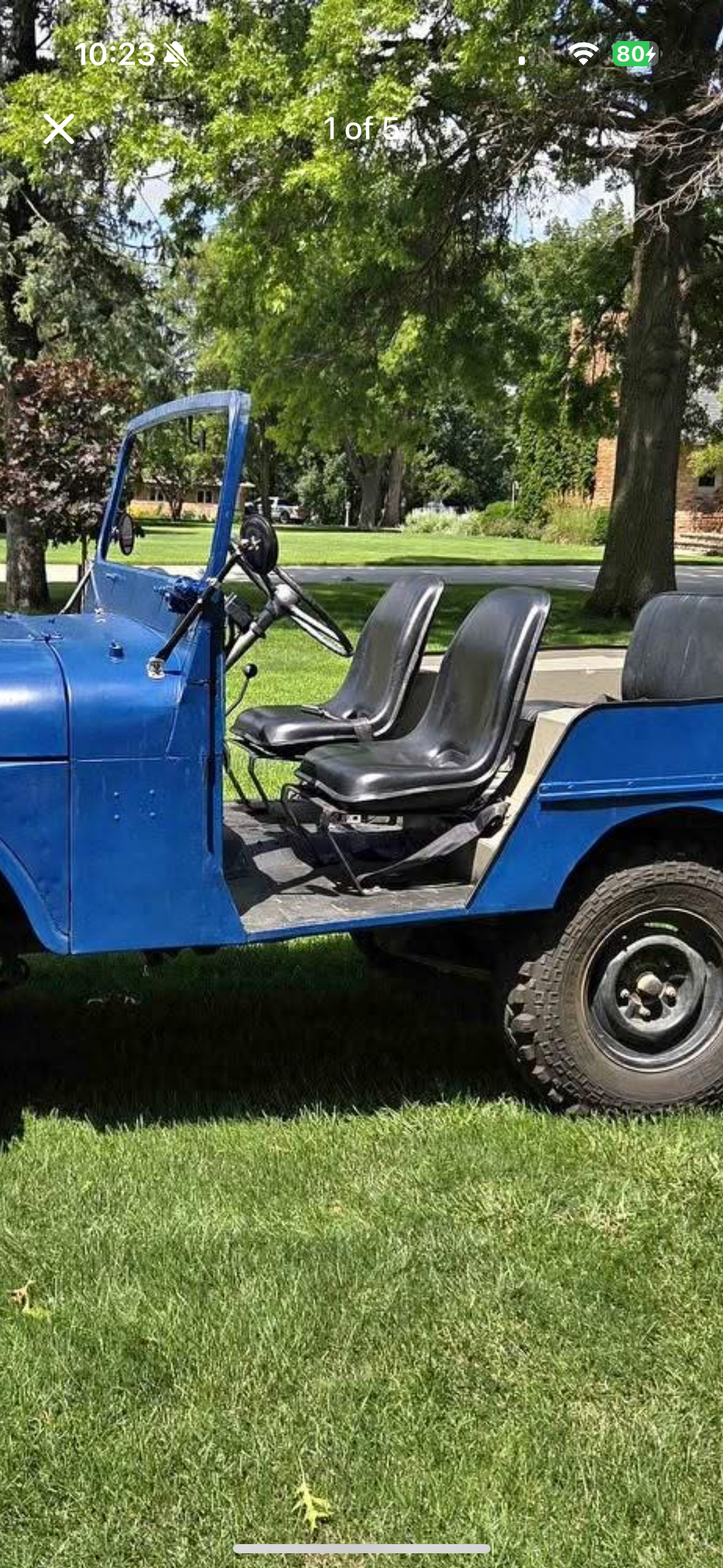

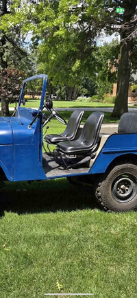

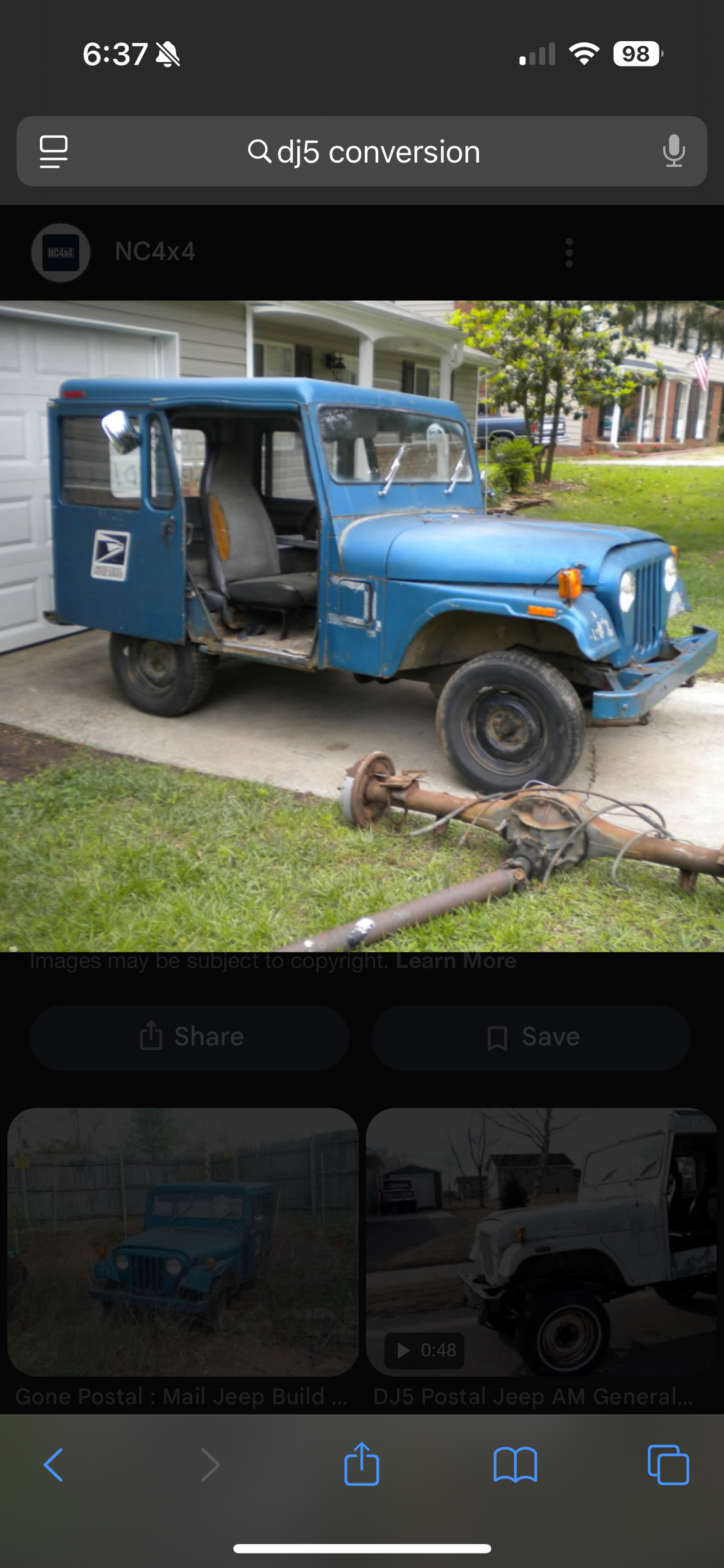

Has anyone Roxor/jeep trimmed the lip by your feet flush to get in/out easier. I’m thinking of converting from a ranger but my only hold ups are the entry issues and the turning radius. Old mail delivery jeeps used to be flush by the feet and I feel like that would be pretty slick on a Roxor.

I myself am fine with stepping over, plus it helps to keep some unwanted water out.

I would bet that the Lip is Structural Support for the body. The Mail Jeep might have some other structural stiffener that is not obvious. Also a Mail Jeep should not have a rough off road life requiring structural strength.

I bet that would really compromise the integrity of the tub when it's twisting off road.
