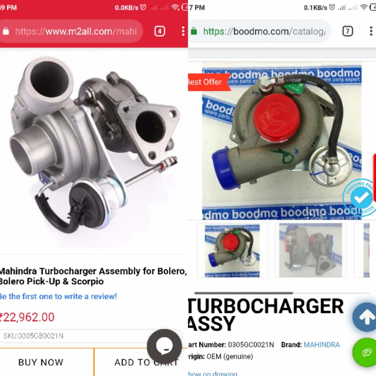

Does anyone, familiar with Roxors, know what brand/type/model of turbocharger Mahindra is using?(maybe it's in house...made by them?)
Is it a variable geometry unit?

Brand: TEL (Turbo Energy Limited)
SKU: 0305GB0021N (plastic WG nipple)
TC image on the left matches roxor.

You will have to verify the compatibility since the part you mentioned has "C" instead of "B" in the SKU. Afaik, 0305GB0021N is for MDI engines that come in Thar DI(roxor) while 0305GC0021N fits NEF based engines in Thar crde. I can't comment on cross compatibility.
