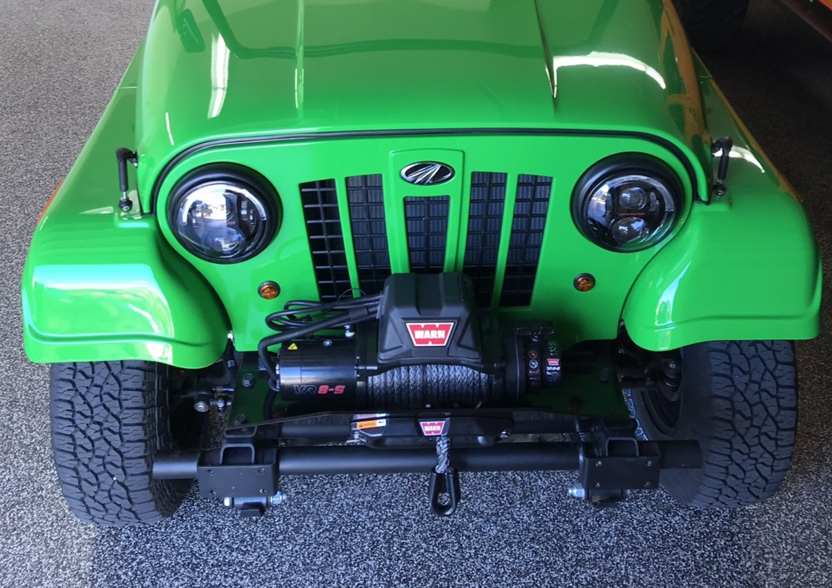

Ive done alot of winching with my atv and i can tell you warn is hands down the best winch to work with out there. Im building custom bumpers for my rox that have receiver ports on the front and rear bumper. The winch can go in either end so if you need to back up you can. I had the montana jacks system on my polaris sportsman and would never have another off road machine that i couldnt swap the winch onto either end. That being said, you can get by with a small winch if you carry enough rigging for doubling back to your machine or rigging a three to one so you tripple your pulling power. My personal favorite is the warn vr 8000. The rox only weighs 3000 lbs so you are over kill on single line pull. You could actually get by with a atv rated winch if you bring a snatch block and extra winch cable to double back. But if you want simple and easy the VR8000 is the way to go for what you described.

I went with a Smitty Bilt 9500# Synthetic Rope Winch. I got it at 4wd.com. Works great, and saved some weight on the front end and no more than I plan on using it, it should do the job! And like you I just couldn't justify the cost of the WARN!!
I got a 13000lb xbull from eBay for just 340 bucks. I comes with synthetic rope, 2 remotes and even a cover. I pulled several people out of a ditch during the snow storm this winter and it worked great.
I have a wireless and waterproof Smittybilt X2O 10k on my open car trailer and like it alot. I'm putting the same on the Roxor. I splurged for the roxor and got the synthetic line. Many of my friends utilizing them on their Jeeps. For the money I don't think you can beat them. Got the steel cable version for $360 from auto anything. The synthetic line was $470.
