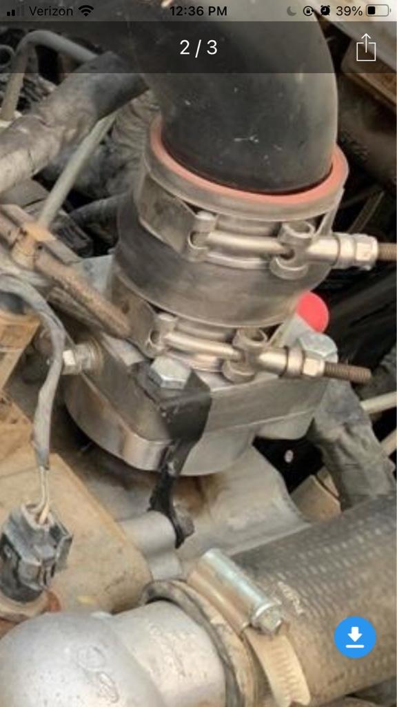

Anyone who has installed the DF intake kit (just the stack, not replacement of the "yellow" tube): thoughts on keeping the factory hold down bracket?
The lady at DF I spoke to said the factory hold down bracket is no longer needed with the dual o-ring piece.
I decided to keep it after installing the DF kit (...some of the kit... the mix and match stack in my earlier post).
What did you guys do?
Realize this doesn't directly answer your question, but since I'd bought and installed the after market OTR hold down brackets for my 2018s early on, the cost was sunk and, though hardly necessary and redundant, there seemed to be no harm in leaving them in place after the much improved DF kits became available and installed. On one 2018, the OEM gaskets were not salvaged. The other one's gaskets were perfectly reusable. Both the DF kits fit snuggly without alteration. The yellow tubes remain until I can afford to get rid of them.
I had to modify my factory hold down bracket slightly.
I also can say that the hold down is necessary. At some point my hold down came loose the entire stack blew off the manifold once pressurized.
