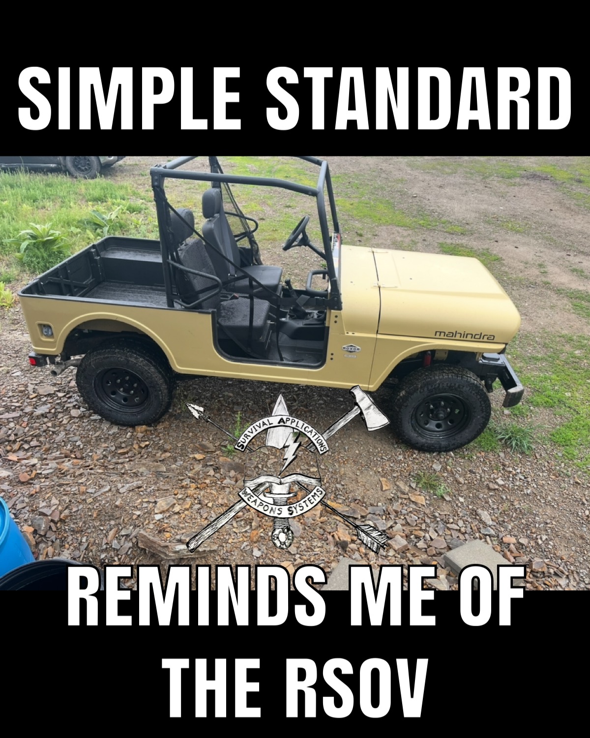

New to owning a Roxor but not new to diesel 4x4s from the world 🌎
The sound of the 2.7 reminds me of the RSOV Ranger Special Operations Vehicle,. pretty quiet and no stalling even at 3mph in the mountains 🏔️
So far a great little machine and way to get around… 👍

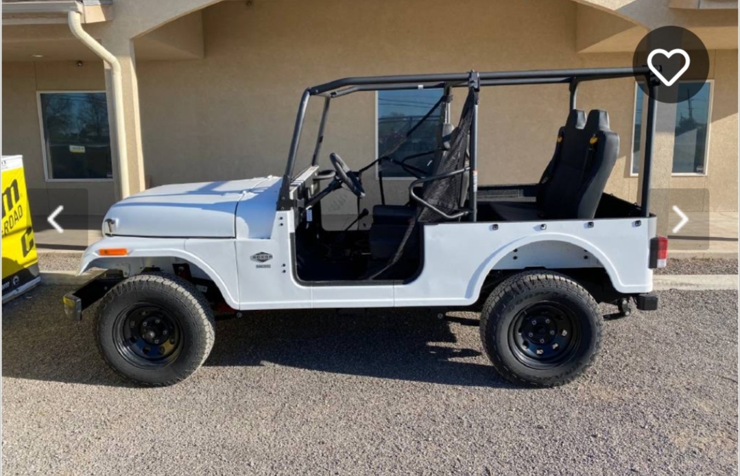

Would really like some sort of 4 seater ROPS or bars, this would help in lifting big rocks 🪨 or elk into the bed.

My 2020 came with the full rops. Traded them with another with sport Rops. Im sure they bolt on the same way mine were. This is when I bought it. Hated thr safari look plus the rear seat. Torqueking.com for gearing and bearings
Cool 😎, we have been using ours for “rat patrol “ shooting vermin etc. The full ROPs would be great for our use. I just can’t seem to find a source of factory or aftermarket 🤷

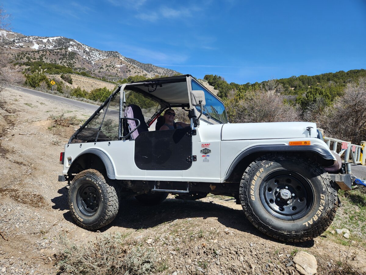

Cecco Racing is the source for the Rear Bumper, Shackle Mounts for the Front Bumper, and Skid Plates. You might ask about the Tire Carrier with Gas Can Mount. I did not see one, but they might fabricate one.
I had my front bumper fabricated from 5 Inch C Channel. It is a 42" Stubby Bumper. The end plates hang down an Inch to keep a jack from kicking out from under it.
Winch Plate was from Diesel Freak. Rough Country I believe.
12,000 Winch from Harbor Freight, as well as the source for 7/8 D Shackle's for all Four Corners. Also a good source for Soft Shackle's and Snatch Blocks. NOTE: Get the Apex Forged Snatch Block, and not the $29.99 one. The Apex is better made, has a grease zerk, and is also much handier to disassemble to clean. It is $20 higher, and worth it.
My 42" Light Bar, and 6 LED Rear Flood Light are also Harbor Freight. My Interior lights are Harbor Freight Rock Lights. One under the dash, and the second on the roll bar.
All Switchs are from Rocker Switch Pro's.
The Tauler Jack Kit from Brennan's Garage is also something to look into.
My first improvement was swapping the factory tires for 235/85R16 10 ply rough tread tires.
I have a Jeep YJ windshield in my Roxor. My Top is a Fortress with the rear dove tail, and my Rear Bulkhead is a Hard Cab from Diesel Freak.
NOTE: You can do the modifications over time. I have been perfecting mine for a couple years now.
