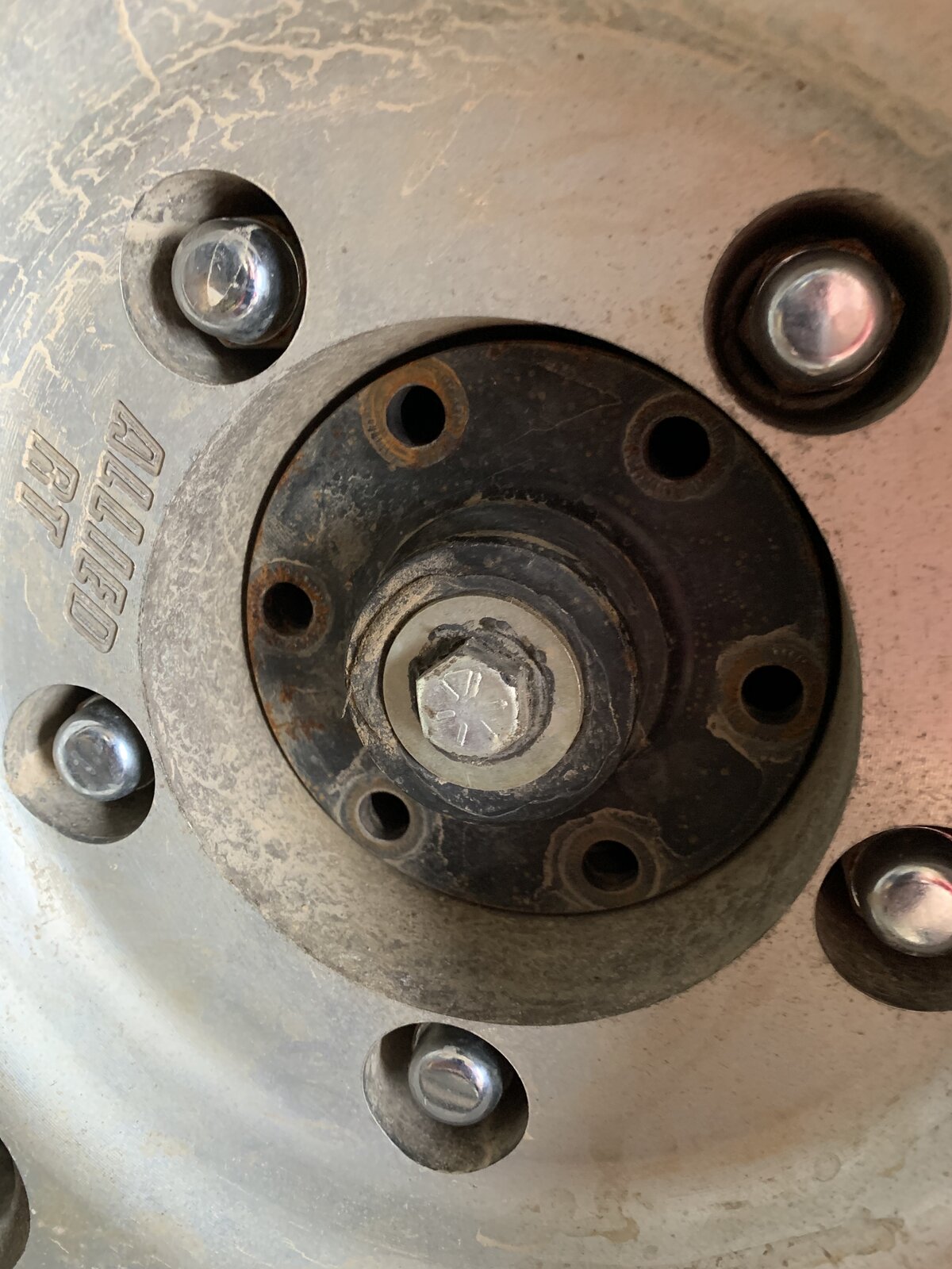

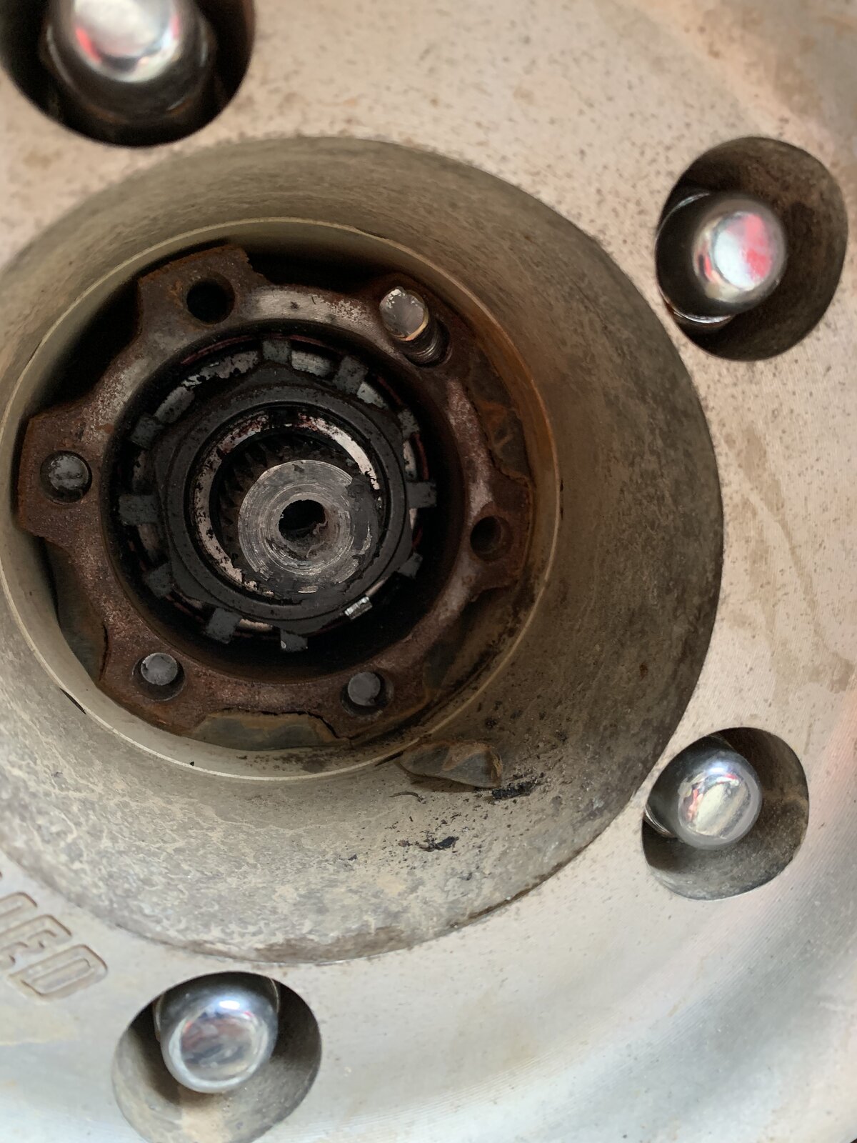

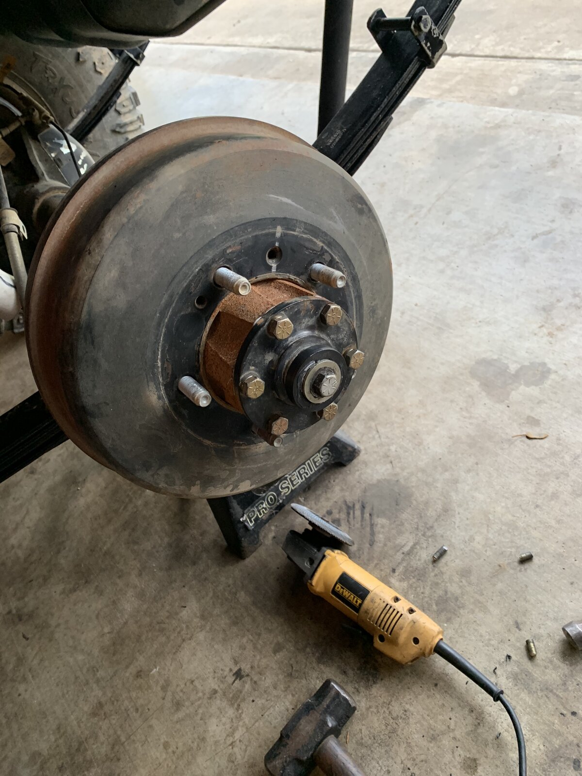

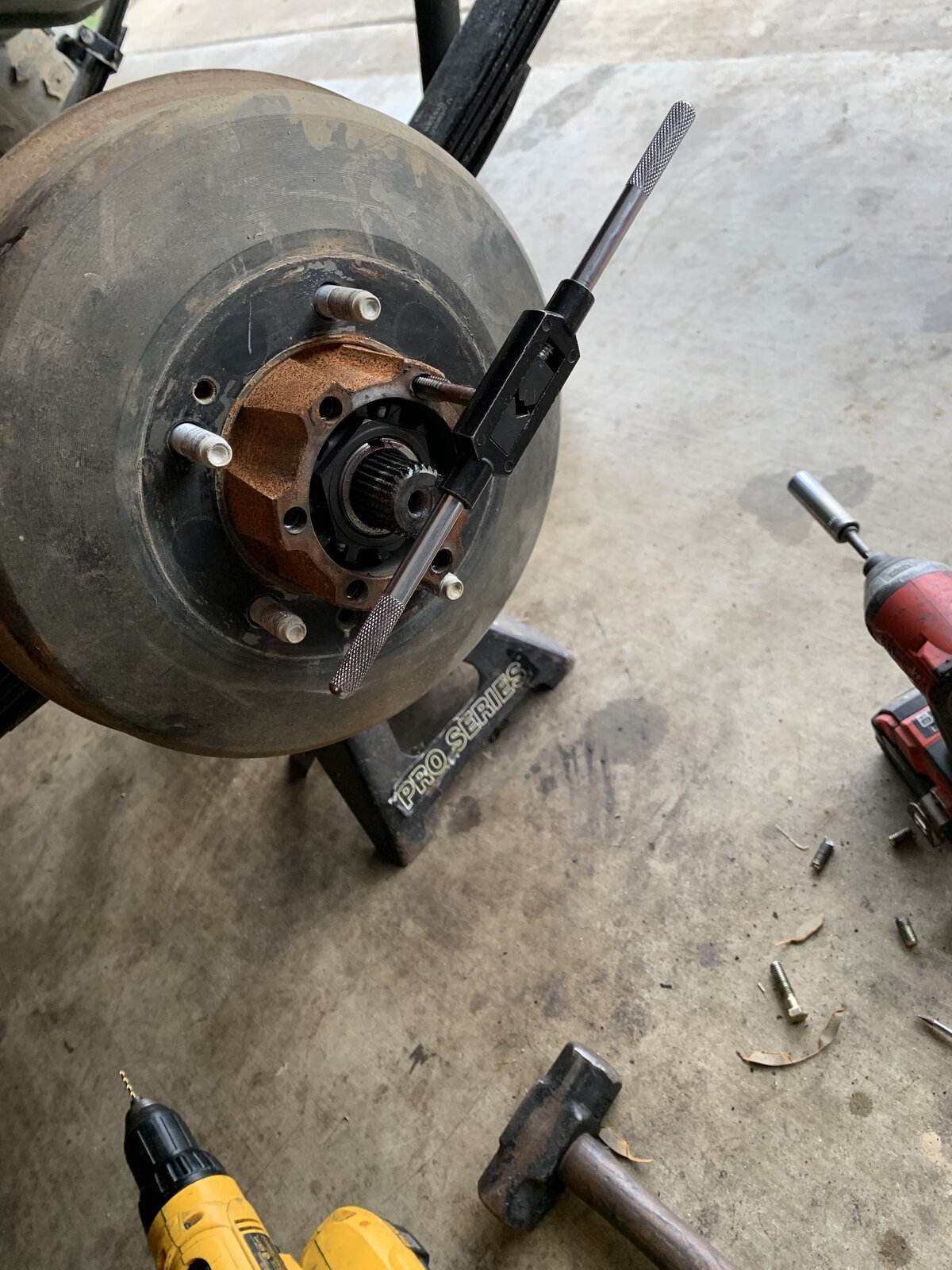

Something to be aware of with a full float conversion kit is the bolts holding the axle shaft to the hub. Please verify the bolt torque. Luckily I was able to repair this and loctite abs torque to 40’ pounds with 3/8” grade 8 fasteners.
