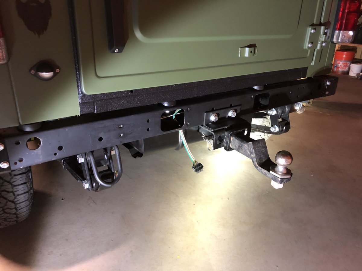

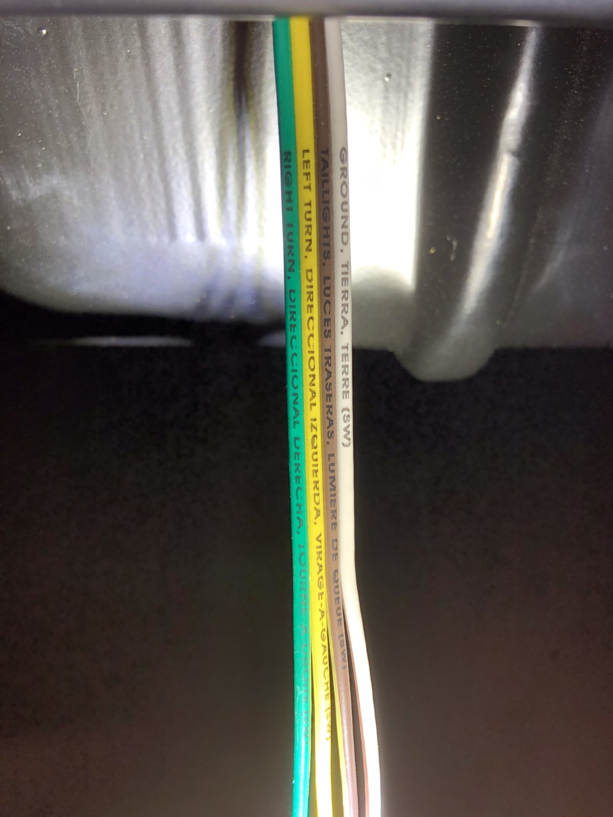

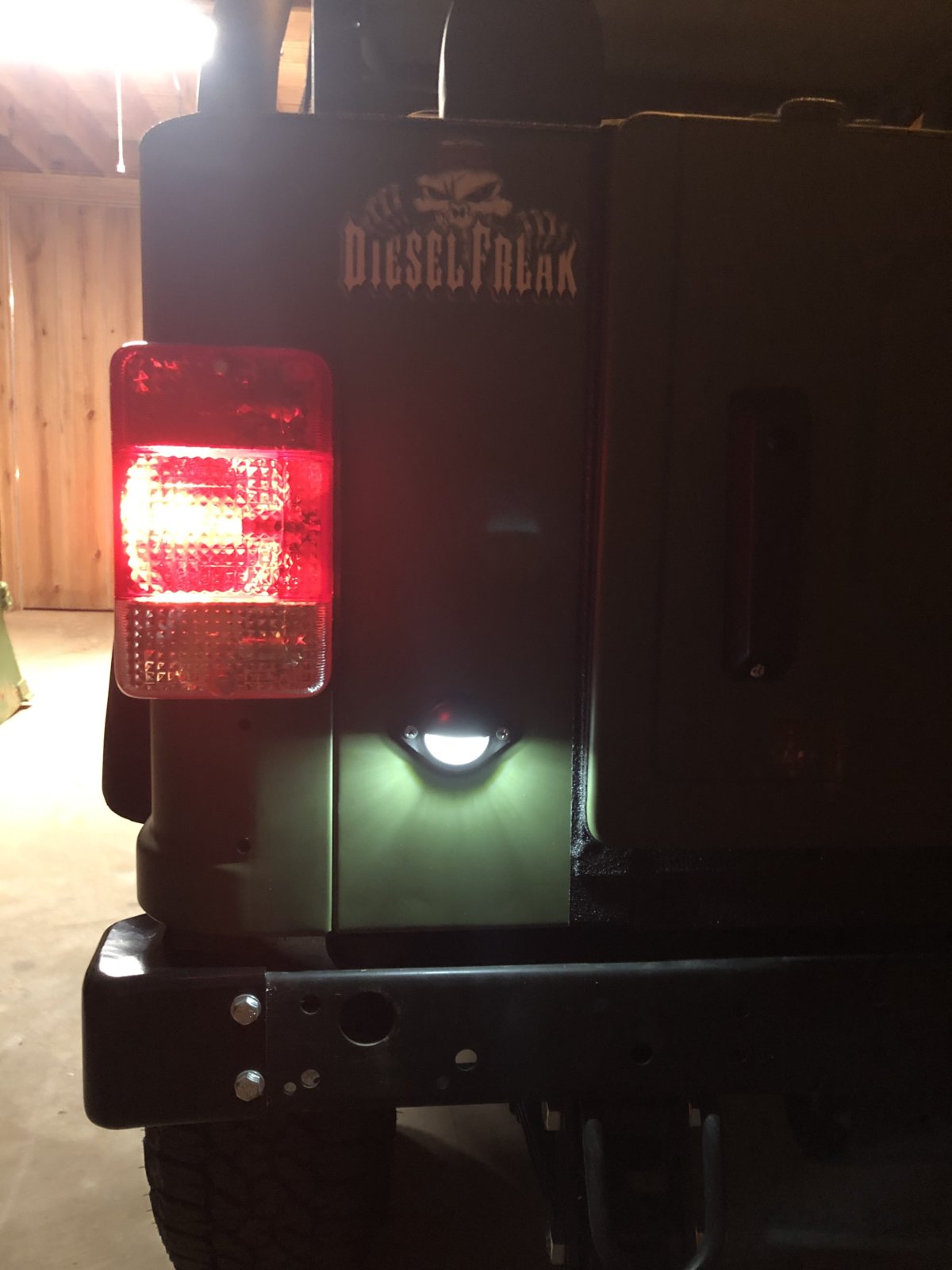

I have installed a trailer wire harness.. I did it while I was installing the on the Rox turn signals. I just bought a harness from Walmart and tapped into the wires at the rear taillights. Obviously if you don’t have turn signals wired up, you’re not going to have them on the trailer but the harness from Walmart has each wire labeled where it needs to go. On the Roxor, the right and left turn signal wire is also the brake lights and the running lights will hook to the brown wire.
I made a homemade trailer hitch but don’t have enough confidence in the tounge capacity to pull my trailers anywhere other than around the yard at the moment. I am currently waiting on my dealer to get back to me on the new 2” receiver mount listed on the Roxor accessories. It claims it will handle the full towing capacity of the Roxor.

No problem. I used a meter to figure out which wire was what on the Roxor but I’ll look at it when I get home and let you know which one goes where to save you the trouble. I am trying to get my Roxor tagged in Alabama but have high hopes and will be doing some trailer hauling myself. Is your Roxor tagged for your state? FYI, my on the rox turn signal instructions were backwards for hooking up the front turn signals. This will make a lot more Spence once you get them hooked up.

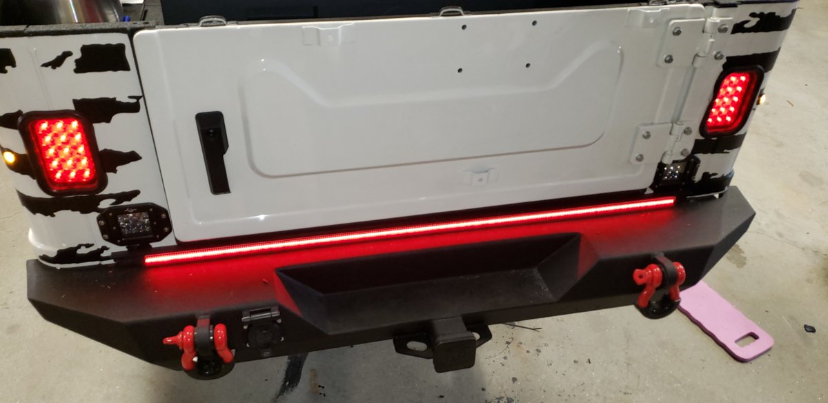

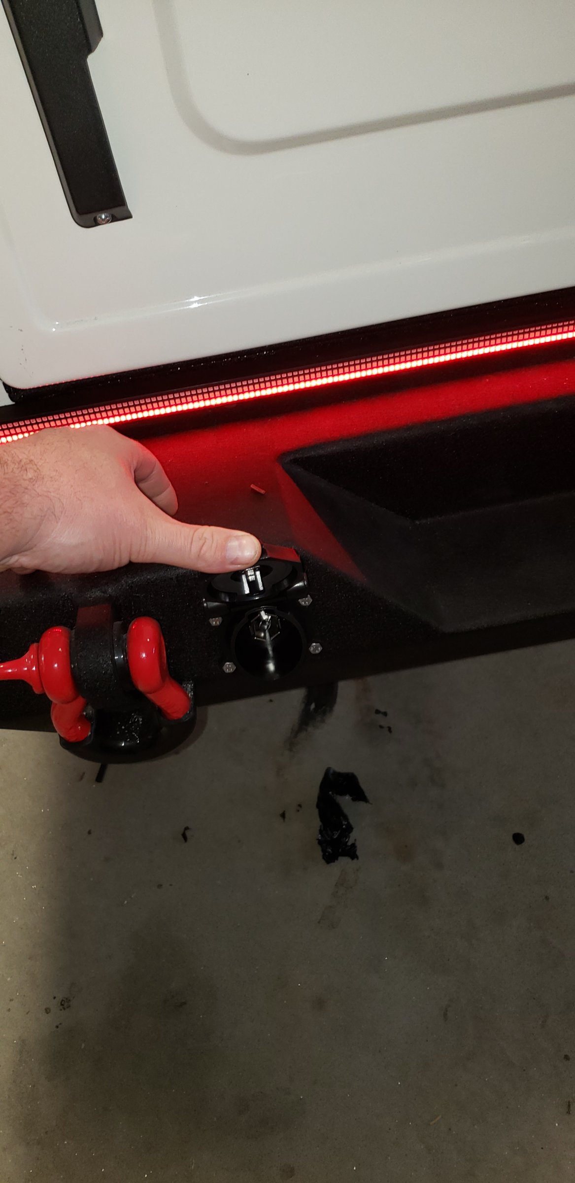

I installed trailer plug on mine as well. This is what I used.... https://www.amazon.com/gp/product/B005S572FI/?tag=roxor-20 You will need the converter if you use the top bulb as your turn lights. Wire as follows: Brown wire on center bulb is the brake; white wire on center bulb is tail, this is where I spliced in the license plate light as well; driver side top bulb is blue wire for left turn; passenger side top bulb is red wire for right turn. Bumper seemed to be well grounded so any of the bumper bolts make for a good ground.
If you look at my thread about Jeep LED tail lights I talk about how to my LED's work with the roxor and how to install a trailer connector to them without a converter box.
