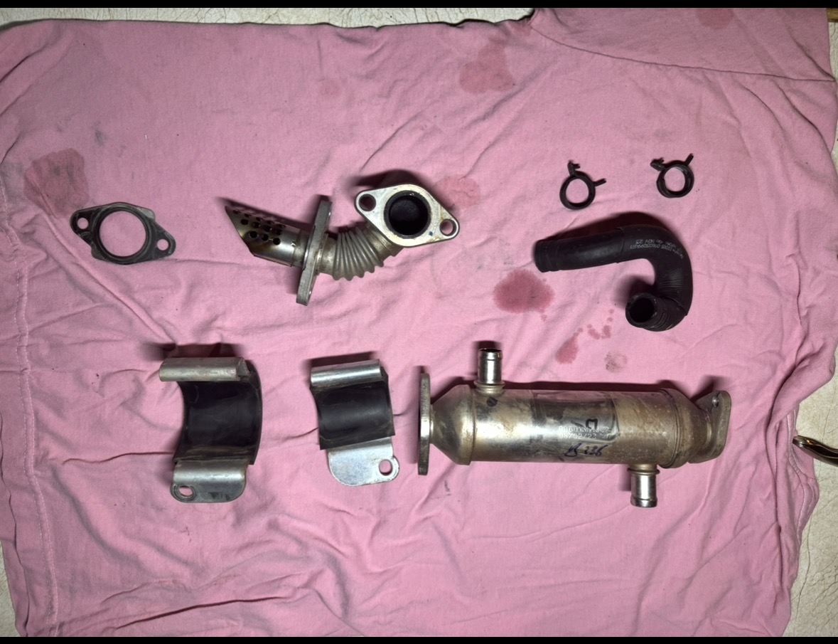

For a 2.7 engine, it’s 2 CNC machined US steel 3/8’s thick block off plates along with new bolts for the exhaust side, coolant drain hose and instructions. If you have a tuned ecm that the egr was disabled, you can remove the entire system. If you have a stock ecm or one that is tuned but the egr wasn’t disabled, you will be able to remove the egr cooler but leave the actuator in place with the the block off plates installed. I’ll post a picture of the parts removed from a stock tune. Install should take about an hour.
Parts removed.
